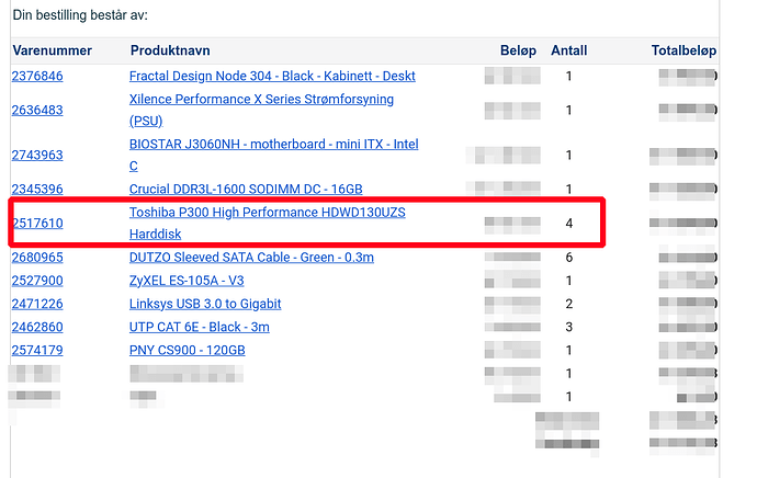

Take some old PC Hardware. Install Freebsd. Install YaCy. NAT Port 8090 to that box and go!
All you have to pay for is the electric energy. Backup / export your URLs as HTM from time to time and:
Enjoy watching your YaCy instance being part of the most fascinating search engine since www.
Professional hosters are good for hosting static content (which YaCy isnā€™t). A reasonable (dedicated) machine to run YaCy will cost you several 100 bucks per month. Everything else is a lie.
All the cloud crap is made to rip off big companies after having them locked in before. Nothing for private freaks to play around :wink:
@zooom
mehā€¦ If somethingā€™s worth doing, itā€™s worth doing right :wink:
I agree, but I donā€™t know about which dimentions you are takling about. All I want to say is, that if you plan to index more than some few websites using YaCy, a professionally hosted hardware will quickly consume a lot of money.
If you have different experience, pls let me know.
Yeah. It is for a home-hosted YaCY machine.
